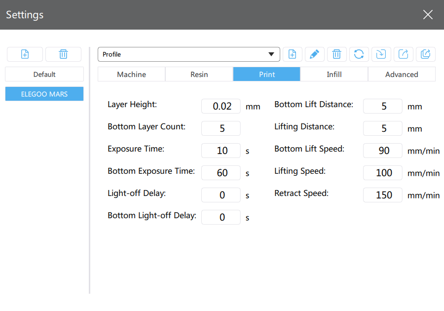

Here my setting :
[Image: image.png.26efa5b77a0497c5757e0bc0bc5f1a1d.png]
After a few layers, a kind of smudge sticks to the center of my print like a kind of skin. I thought of an agglomerate of flakes from unprinted media. I usually use 0.3mm supports. So I pump up them at 0.5mm even a while ago, I gone to 0.8.
what so ever the problem persists.
So I thought about the suction effect in the middle of the tank, I retensioned the FEP using the sponge method (https://www.youtube.com/watch?v=tsokPTRL...ooOfficial)
And today, It's even worse.
My print was good on a side of the tray not on the other where just half of the print was good. All the rest sticks to the tank bed.
Please do you have any ideas where can from my troubleshouting, it's already a month I broke my mind to know where are my mystakes and I start get crazy
Help !!!!
Thank you for the futures answers

it is most likely that the LCD shutter has gone bad--it is a "consumable" component (a "wear item") and typically wear out after 250 to 300 hours of printing. You can read more about how the shutter works and why they wear out in my post here.
If your printer is a year old and you have not yet replaced the LCD I guaranty that is the problem--in fact so does Elegoo, thay only warranty it for 3 months--from the owner's manual:

You've right, I tested the screen with a basic rectangle to see the whole screen. The screen test from Elegoo isn't enough efficient. There are many black holes everywhere on it.
I ordered new one since, I must just install it now ^^
