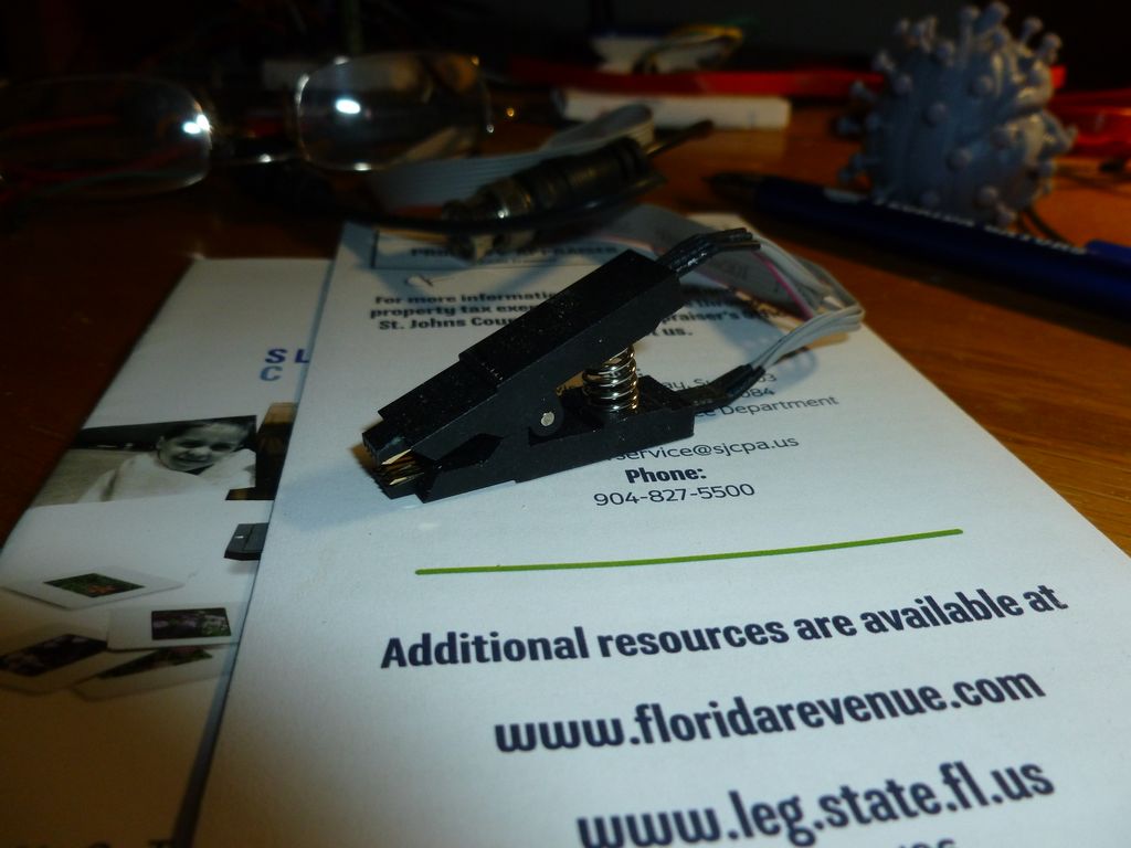

I tried making an IC test clip like this; using Siraya Tech's "Sculpt" resin (one of the better I've used):
[Image: ICTestClip-00.jpg]
I had made the hinged sections 25% or so larger and increased the pivot pin diameter. It still failed miserably, barely surviving assembly and breaking on first use.
Quite disappointing.

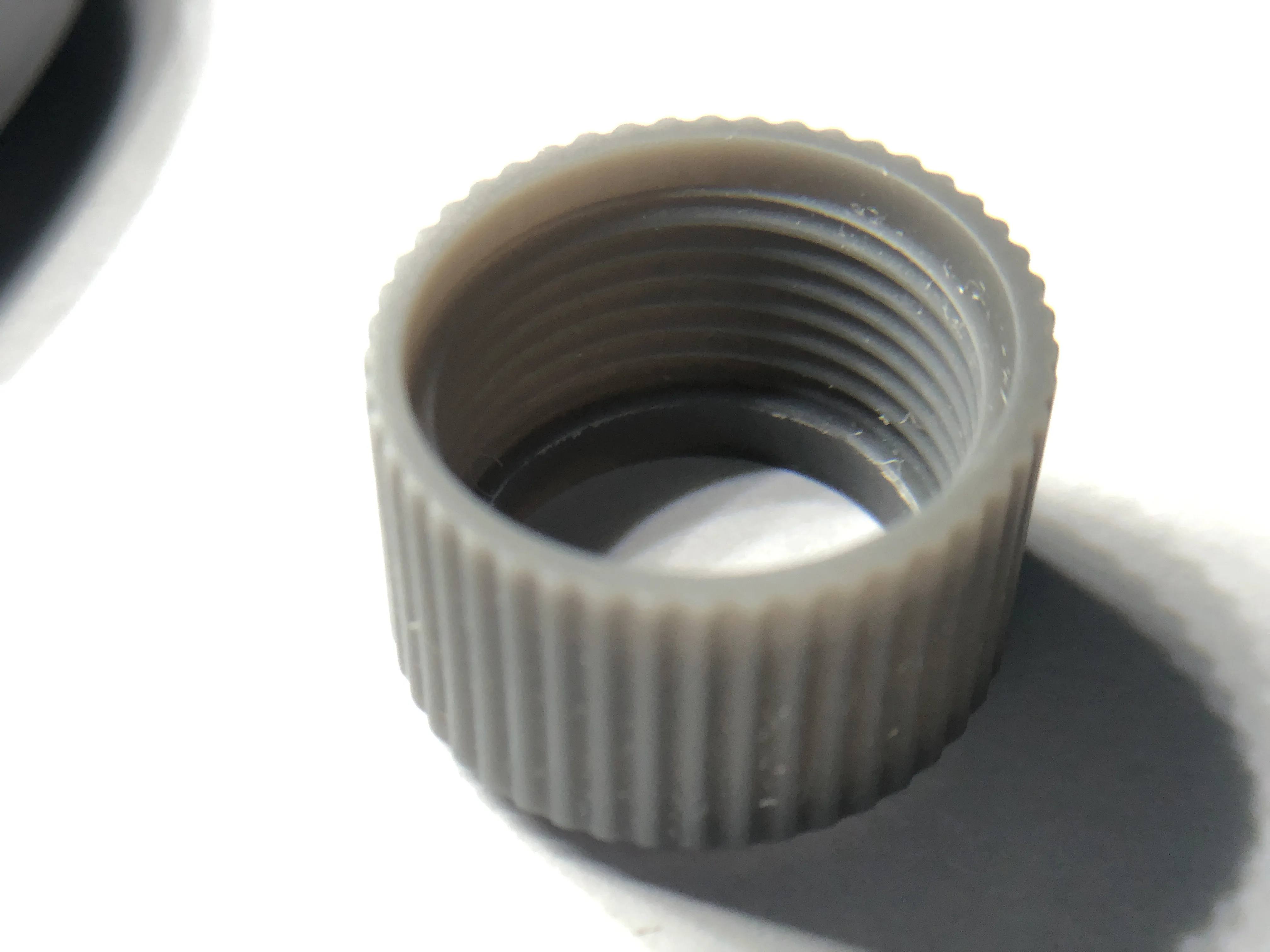

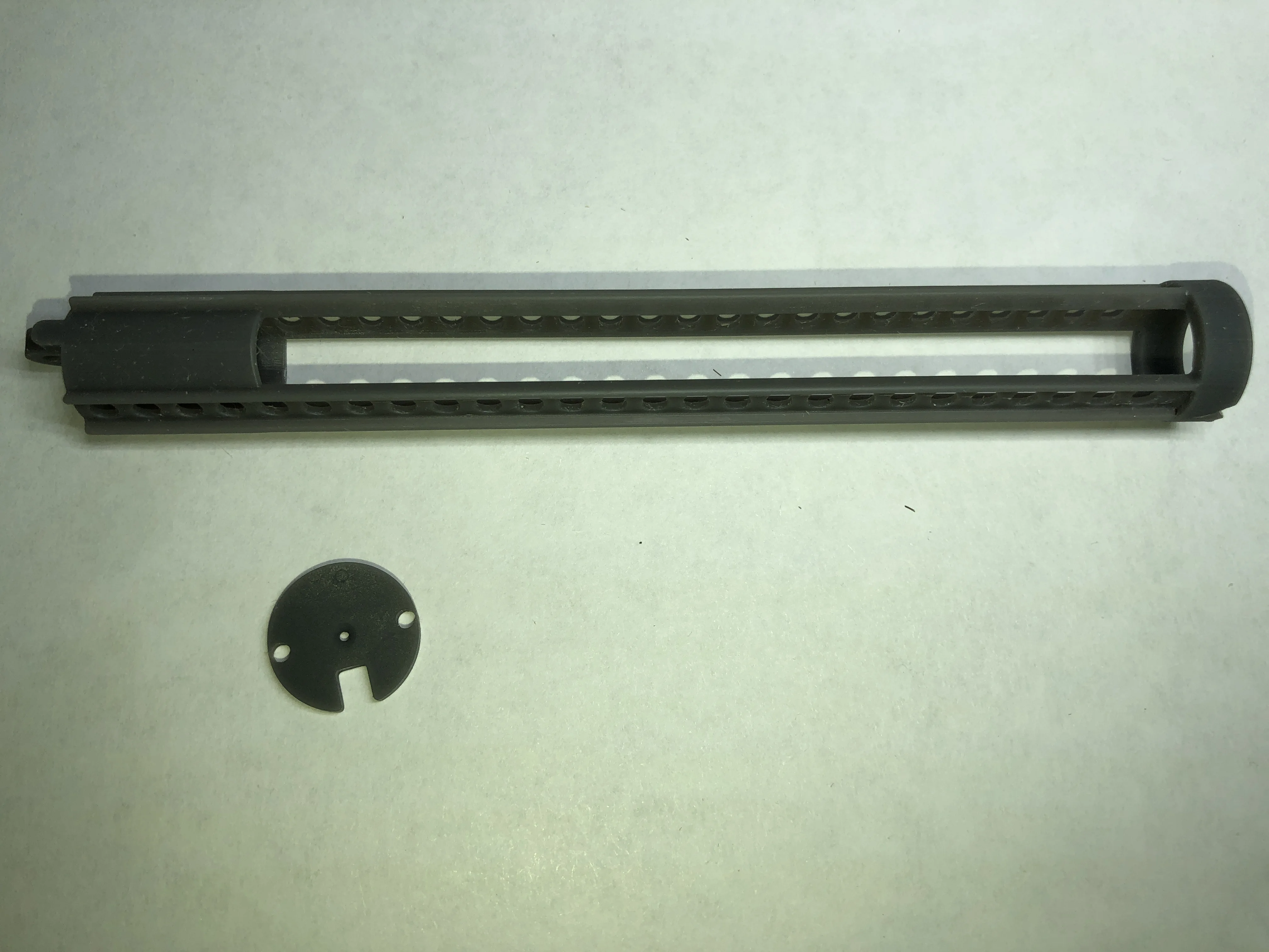

Printer is just a printer. If you buy flexible resin, you will produce flexible parts. If you buy semi-flexible resin (for example FUNGDO High Toughness) - you will get semi-flexible parts at small thickness or touch and strong parts at sufficiently large thickness. There is also FUNGDO Low Viscosity ABS-like resin, it is slightly more heat resistant than real ABS and has excellent adhesion, I can print much more parts without supports. For example, on this photo you can see example of long thin-walled part which was printed vertically - it had little contact area during printing, just a circle with relatively thin walls at the base (on the right on the photo), and no supports:
[Image: Udef5bace5b3f4430a55c57e4c1c670caJ.jpg]

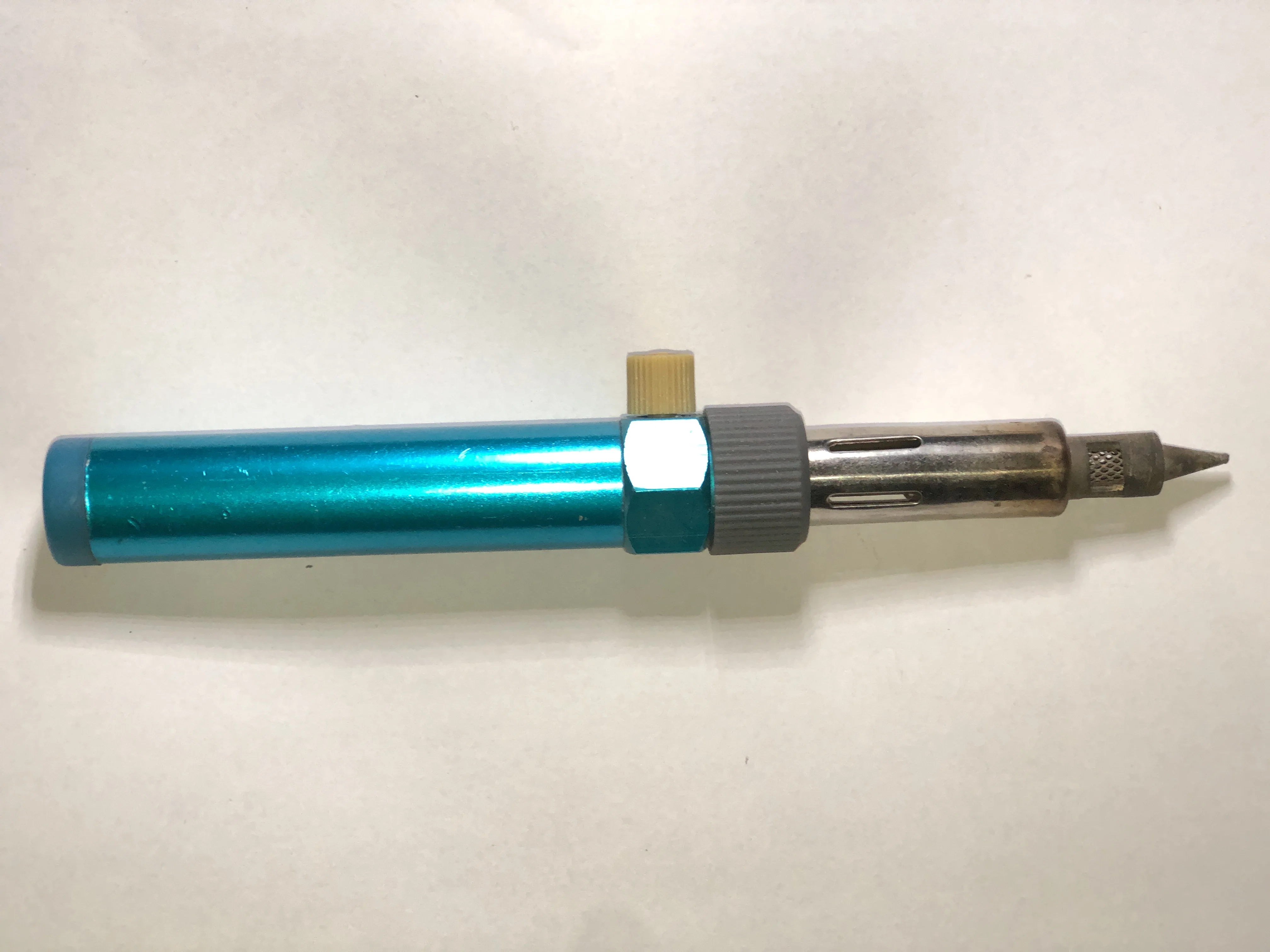

Also, I was able to repair my soldering iron. Its original nut was made out of ABS and it quickly degraded from heat (became fragile and cracked in multiple places). At first I have tried to replace it with a a nut printed on my FDM printer using high quality ABS filament (very expensive filament comparable by price to this resin), but it degraded even more quickly than original nut (it did not melt, but became fragile and eventually cracked in multiple places, like the original one). But then I printed the nut with Low Viscosity resin:
[Image: U59d423e81e2a4bdbb93260f0846b2151B.jpg]
[Image: U66050baf9bd547f8a06f2b43e7ea803ef.jpg]
At the time of writing, almost five months has passed, no signs of degradation at all despite active usage! I was surprised to discover that this resin is actually better than real ABS.
