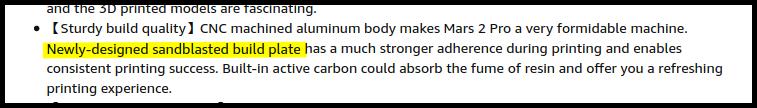

I have determined that the nearly universal build plate adhesion problems being experienced by "Pro" owners is a problem with the build plate's almost mirror-like surface finish--see my posts here and here; and "Lat2730's post here
Elegoo has realized this too as evidenced by the newest Mars 2 Pro having a sandblasted build plate finish:
from the Amazon M2P ad copy
[Image: MarsPro2Platen.jpg]

I Read The Post U Link So I READINGG And With Talk To My Mate That Sandblasting Or Grit UP The Plate Might Be A Option for me now got new plate come also found out the pro 2 has sand blast finish compare to pro also got the wham bam flex plate as they got better looking finish but that be 7 day to try them but amazam pro spare build plate I have order I get sand back with fine grit at work or wet dry it with some 400 to 600 grit I have
Was Also Going Try The clear blue resin but didn't want that fail as well so I keep trying with gray ASB like one using the spread sheet people made for there tried setting for them rason large list of them
They Say For Thee Gray. 05 layer 11 sec with 1m5 off set for normal 90 bottom 10 layer
Try on plate see if get any thing using the exposure test print that youtue does as only 30 layer quick print that just printer on the plate no raft or thst as that one only ever get first 2 layer then fail if soen work on them setting then rough it up or wait to get the new plate do it. that that stick the flex wham bam plate system on the pro build plate and try that lol
