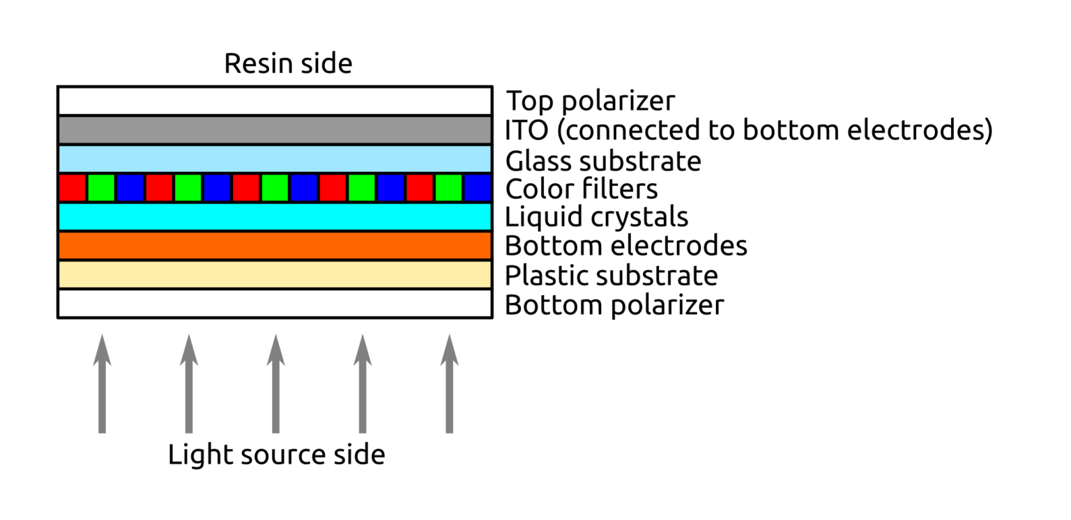

I'm not 100% certain on what is being talked about here... Are you talking about removing the bottom polarizer film?
![]() I wouldn't remove the top one. Not sure if removing the bottom one would help. In a perfect one if you could remove the color filters, that might potentially help, basically making a ghetto monochrome screen, but it seems pretty impossible... https://blog.honzamrazek.cz/2020/02/maki...onochrome/ (09-20-2020, 02:28 PM)NeSs7or9 Wrote: I wouldn't remove the top one. Not sure if removing the bottom one would help. In a perfect one if you could remove the color filters, that might potentially help, basically making a ghetto monochrome screen, but it seems pretty impossible... Yeah, I saw that fellow's posts--he mostly screwed up a perfectly good LCD... Removing the bottom polarizer would of course pass non-polarized light to the crystals, some of which would pass through the crystals and the upper polarizer regardless of the crystals' molecular orientation... |
