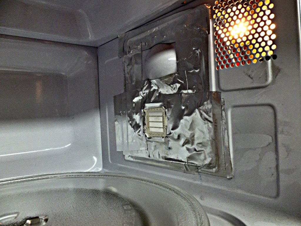

The UV LED was mounted (w/ heat sink compound) to an old CPU heat sink, that assembly then mounted in an enlarged hole where the magnetron and it's waveguide had been in the side of the oven. There was plenty of room in the oven's side compartment for the LED, heat sink and LED power supply. There are two screws mechanically fastening the heat sink to the wall, I used metallic duct tape to seal an "pretty" it all up.
The microwave's active cross flow cooling, designed for a 700 W device, is entirely adequate to the 30 W LED's cooling needs.

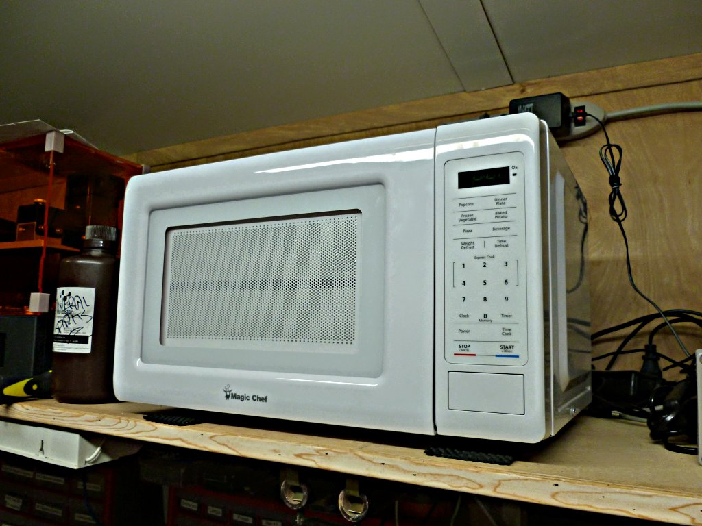

just a plain 'ol microwave
[Image: Mychamber_Frnt.JPG]
UV LED mounted on an old CPU heat sink and installed in place of the magnetron--the "bump" above the LED is left over waveguide I did not remove. (I see I need yet to clean up some of the grinding dust from enlarging the hole):
[Image: Mychamber_LED.JPG]

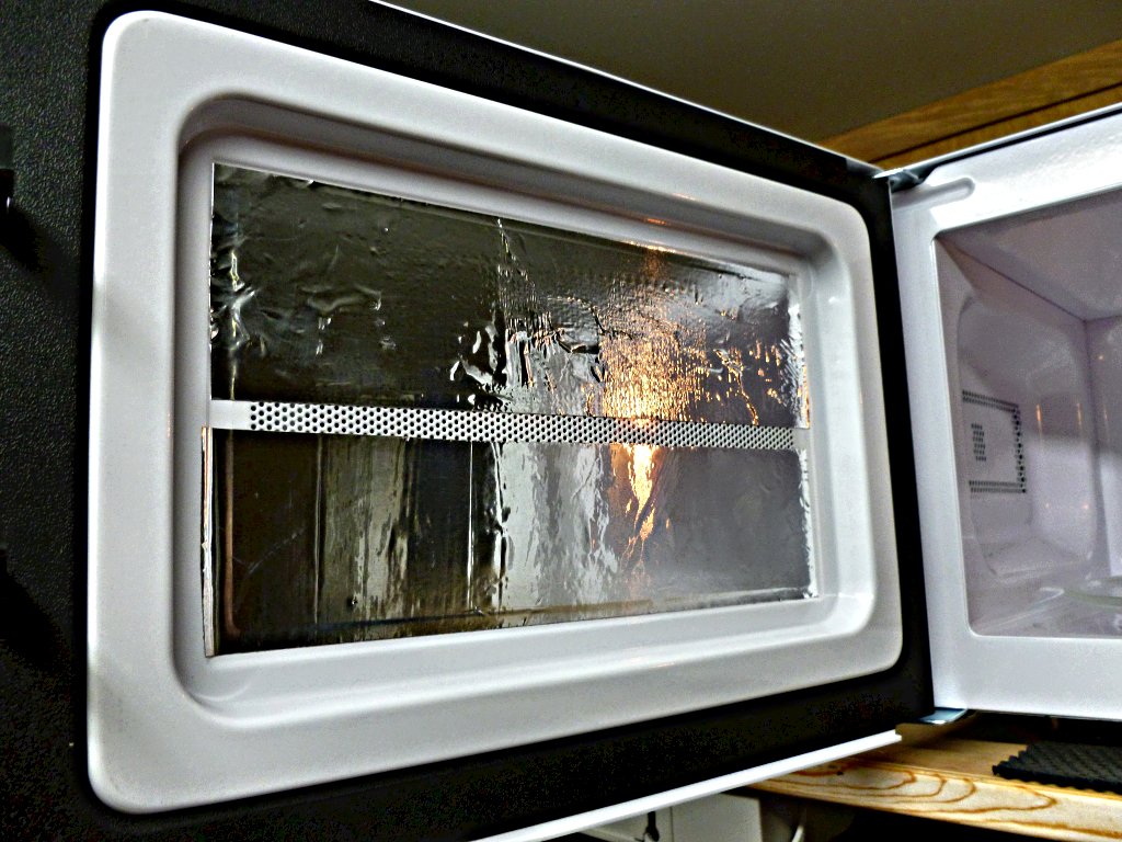

Chrome duct tape on window in m-wave door--I had considered lining the entire interior with foil, however with the 30 W LED the gloss white seems to relect the UV quite well...
[Image: Mychamber_Door.JPG]

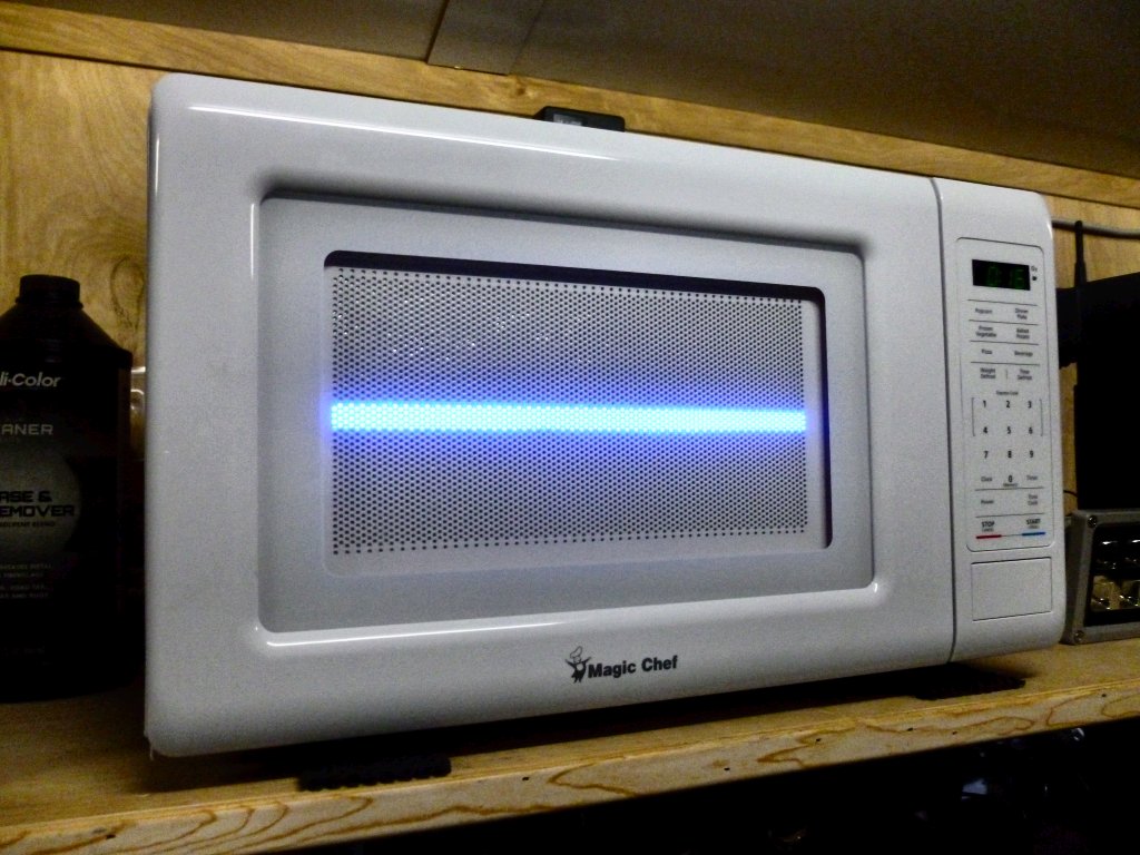

LED ON
[Image: Mychamber_LED_ON_bright.JPG]

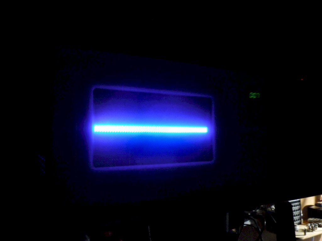

LED ON, lights off
[Image: Mychamber_LED_ON.JPG]

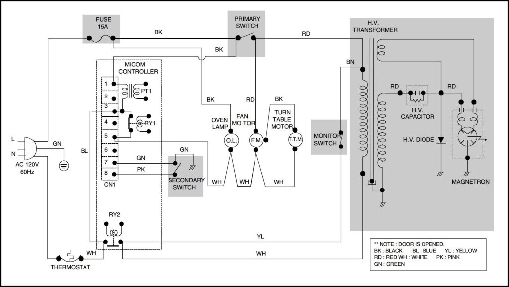

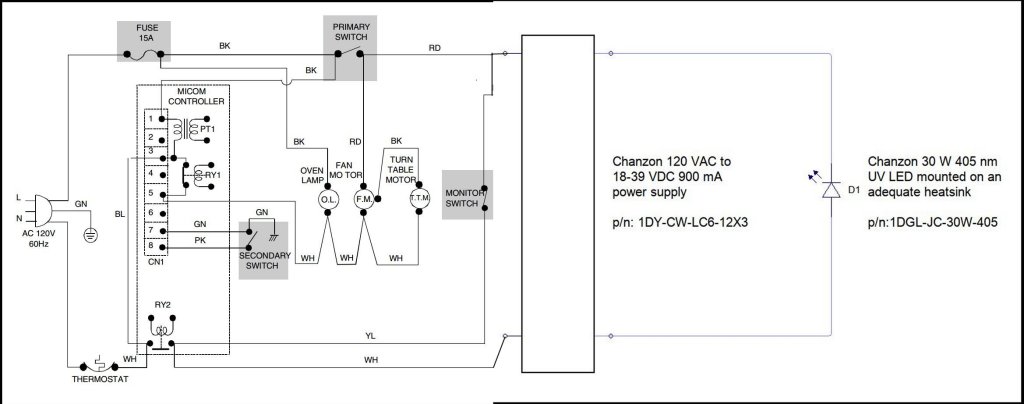

OEM schematic of m-wave
[Image: UECIDE0-1_Stock.jpg]
As modified schematic of m-wave
[Image: UECIDE0-1_Modded.jpg]
