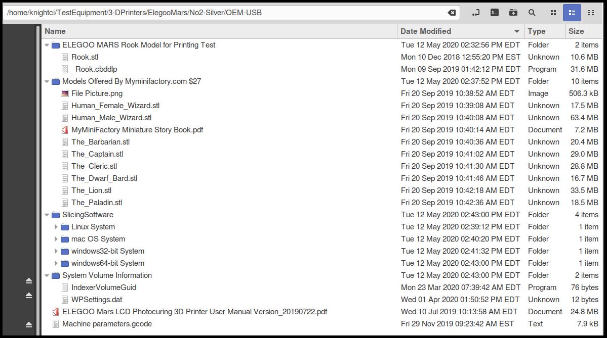

I would assume you have performed a cold boot on the printer--with the jump drive not installed? Then install the card and try again...
Can you read the USB drive on a PC?
Here is what the directory structure of the flash drive that came with my newest Mars looks like--there is no sub-folder of System Volume Information named System Volume Information, nor is there a file named Rook-2019:

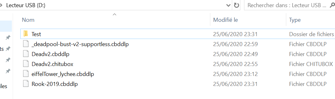

Did you save the file into the System Volume Information folder (Windows should not have allowed that)? That folder is a "system" folder, normally not visible by the Windows File Explorer. I am running Linux which considers it to be just another folder...
What does the directory structure of your USB drive look like?
Reply
#5
It look like this. Nothing else.[Image: 4DwwabK.png]
