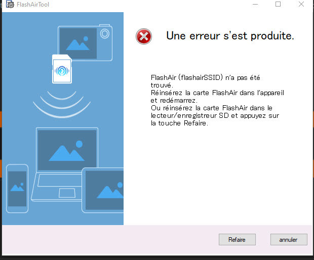

Hello i try to do this but i m block on this
[img]<a href=[/img][Image: ypgk.jpg]" />
can you help me ?
